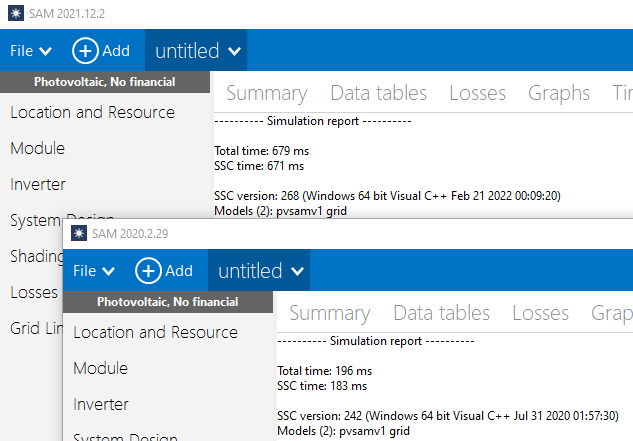

28 Mar 2022 11:28 - 28 Mar 2022 11:31 #10734
Replied by Paul Gilman on topic Slower execution time in new version
Hi Florian,
Thank you for the additional information. I was able to confirm your observation on my computer:
I think the longer simulation run times for a Detailed PV / No Financial case between SAM 2021.12.2 r2 and SAM 2020.2.29 r3 are due to improvements to the backtracking algorithm and, for subhourly simulations only, the addition of a new transient thermal model for cell temperature calculations. These changes are described in the release notes for SAM 2020.11.29: nrel.github.io/SAM/doc/releasenotes.html#2020-11-29 .
I will check with the model developers and follow up if they have any additional insights.
