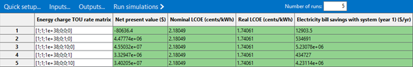

Attached is a .sam file with a parametric simulation set up to do the comparison you describe below. Here are results from that file showing that the LCOE remains constant over the range of buy and sell rates while the NPV and annual bill savings change:
Click Parametrics under the Simulate button to see how I set up that analysis.

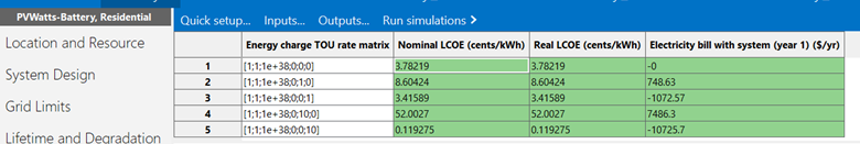

thanks for the quick response, I reckon that the simulation you have used is PVWatts, Commercial, however I am interested in PV-Battery-Residential.
I have run the simulation for PVWatts-Battery, Residential and here is the result:
The LCOE for zero electricity rates is 3.78219, when the buying price becomes 1$ the LCOE becomes 8.60424, the difference is 4.82205.
Now for buying price of 10$ the LCOE becomes 3.78219 + 4.82205 * 10$ = 52.0027 exactly as in SAM.
The same happens for the selling price, there is a linear dependency.
Now here is for my original question for PV-Battery, Residential:

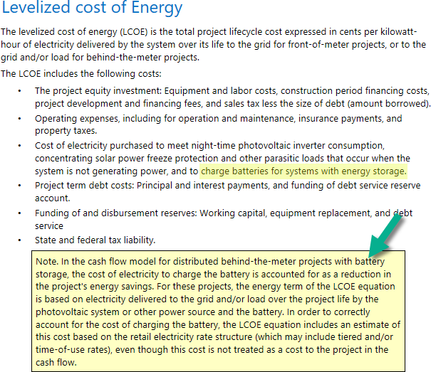

For behind-the-meter systems with batteries, SAM accounts for the cost of charging the battery in the LCOE calculation. This is explained in the description of LCOE in Help:
This approach ensures that comparing the LCOE for projects with and without storage is meaningful.
The note later in the topic that says "For distributed behind-the-meter projects, the retail electricity prices from the Electricity Rates page do not affect the LCOE." is misleading. That is only true for projects with no storage. I will revise that for the next update to SAM.
