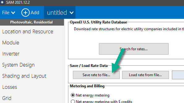

There are a couple of ways to export data from the Electricity Rates page. You can export all of the data to a text file using the Save rate to file button near the top of the page:

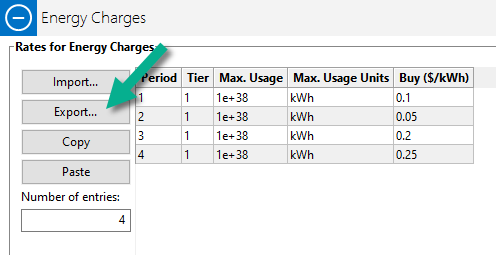

You can use the Export or Copy buttons in the energy or demand rate table to export the TOU data in the tables, but that does not export the weekday and weekend schedules that you show in your screenshot:

Hi Mike,
That's what the Save rate to file button is supposed to do. There seems to be a problem with it in SAM 2024.12.12 that we will fix: github.com/NREL/SAM/issues/2007
