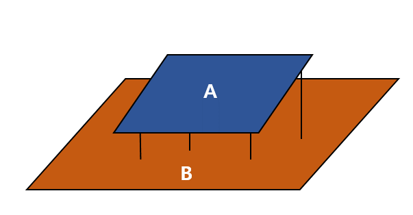

I have few questions about setting GCR value in SAM.
1. Meaning of GCR
Is it correct that the GCR value becomes 0 when the PV system consists of only one array?
If not, does GCR mean the area of installation divided by the area of the panel? A/B

The GCR is defined as the total module area divided by the total ground (or roof) area occupied by the array.
In SAM, the GCR only affects the production estimate if self shading is enabled on the Shading and Layout page. SAM's self-shading calculations assume modules are arranged in parallel rows, and uses the GCR to estimate the distance between rows.
For an array with modules in the same plane, there is no self-shading, so you should disable self shading so that the GCR doe snot affect the production estimate.
