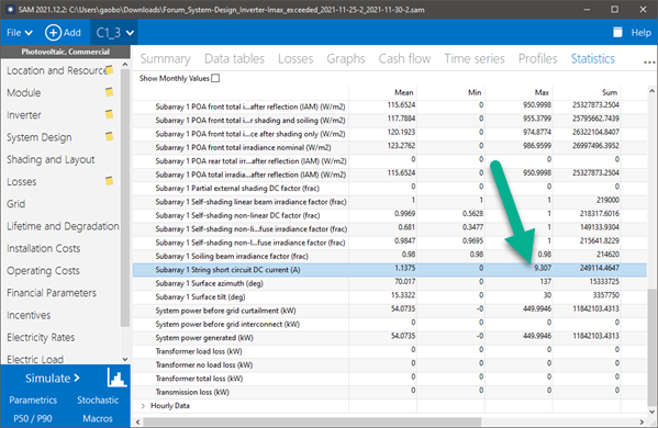

Replied by Paul Gilman on topic System Design exceeds Inverter Maximum DC current: No Error Message
Hi Patrick,
During the simulation, SAM limits the inverter input voltage to the min and max MPPT voltage ratings and its AC output power to the rated AC output power, but does not check the input current.
You can check the short circuit current of each subarray in the outputs to see if it exceeds the rated limit. For example, on the Statistics tab of the Results page after running a simulation, look at the "Max" value of Subarray 1 String short circuit DC current (A).

I followed your instruction and Subarray 1 String short circuit DC current (A) = 10.8 A
How is this possible when one module hence one string has a Short circuit current (Isc) = 9.81 A ? I assumed that the Subarray 1 String short circuit DC current (A)should never exceeds 9.81 A, but it does?
In my System Design with 120 strings in parallel, this would result in 120 * 10.8 A = 1296 A. This is significantly more than the 20x inverter's max. DC input current of 49.5 Adc per inverter, meaning 20 * 49.5 Adc = 990 Adc < 1296 A. Wouldn't be a warning by SAM useful?
Thank you again for your time! Best, Patrick
