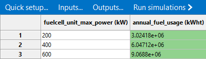

In my tests, the annual fuel consumption increases with fuel cell nameplate capacity. These parametric results are from the "Default 200 kW Fuel Cell" case in the attached file. You can also compare the hourly fuel consumption between a 200 kW and 400 kW fuel cell by comparing the cases in the file.

Hi Paul, thanks for the prompt reply. It seems that it was an error on my end, which I believe I have identified.
Thanks to your file giving me a point of comparison, I found that a different parameter was changing when stack size was varied, which I'm assuming leads to the difference in fuel consumption. It seems that when varying the stack size or nameplate parameters, the calculated rate up/down limits change, while in the file you sent I noticed they remain the same regardless of stack size or nameplate value. Are there any pointers you could give me as to why this occurs?
