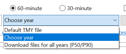

I used a weather file from the NREL National Solar Radiation Database (NSRDB) that I downloaded from SAM's Location and Resource page using the latitude and longitude from your file. You can use the Choose Year option to download a weather file for a specific year:

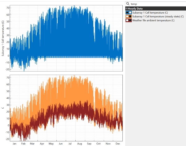

Here are results from the heat transfer method using an hourly weather file from the NSRDB for 2015 at latitude = 40.73 and longitude = -77.94 decimal degrees:
