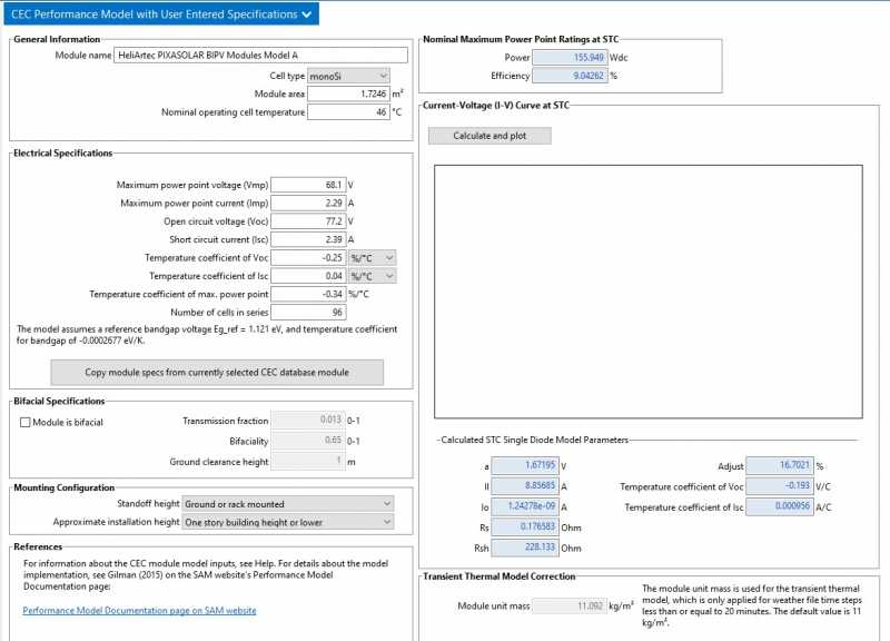

today I've tried adding a PV Modul to SAM. The specifications are from the manufacturer of the module. After entering
the specs I clicked on "calculate" in the "Current-Voltage (I-V) Curve
at STC" and got the error message "could not solve, check inputs".
I checked the specs again but didn't find any deviations from the manufacturers fact sheet.

I 've added a screenshot of the entered specs. Disregard the "Calculated STC Single Diode Model Parameters", as far as I remember, these where added when I clicked the "copy module specs from currently selected CEC database module". Before that, the "Calculated STC Single Diode Model Parameters" window was blank.

Hi Torsten,
Please double-check the values and units of the temperature coefficient of Voc and Isc. Be careful that the units selected in SAM match the units on the datasheet.
If all of the data is correct, please try changing the cell type to see if the solver is able to converge using a different cell type.
If you continue to have trouble, please attach a copy of or link to the datasheet of the module you are trying to use.

I have found the problem. First of all, the number of cells was wrong, its 138. But more importantly, I can't use the V_mpp the manufacturer provided, which is 68.1 V, but instead I can use at most 67.96 V. If I use that value it works fine.
