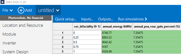

The bifaciality input determines the efficiency of the photovoltaic cells on the rear side of the module: The cells on the rear side of a bifacial module are usually not as efficient as the cells on the front side of the module. The bifaciality does not affect the amount of solar energy that reaches the back of the module, so it does not affect the rear-side bifacial gain. It does, however affect the amount of electricity generated by the array as you can see in the parametric results below from SAM 2020.11.29.
