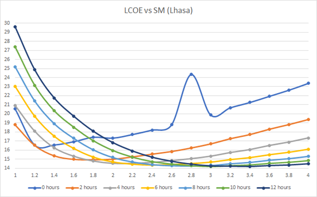

Graph plotted for LCOE vs SM for a location with high solar irradiation was created by Weng Pin Wong
Dear Paul,
The picture below is a graph plotted based on the simulation of CSP-PTC plant in a location with high solar irradiation (Lhasa). I found that the graph plotted when the TES hours is 0, the trend of the curve is quite different from other cases with TES. Although I found some similar trend from some studies but this graph seems deviates a lot around the SM value of 8, may I know is this trend normal or do I make some mistakes during the simulation?
Hope to hear from you soon!

Hi Weng Pin,
I'm not sure what is causing that anomaly in your results.
