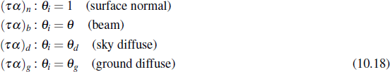

Where can I find the beam effective irradiance angle used in eqn 10.18 ? Is it the b value found in 4.15, 4.18 or 6.15 ?

Replied by Paul Gilman on topic Confusion Regarding Irradiance Calculation
That "G" value should be equivalent to the subarray "POA total irradiance after reflection".

Hey Paul,
Can you let me know about my other question regarding the beam effective irradiance angle in equation 10.18.

Are you saving AOI is equal to the beam of incidence theta_b in 10.18 ? So when solving 10.16 for Ta_b I should be using AOI as my theta_i in 10.16 ?
