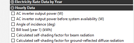

- Hector Akuta
06 Sep 2022 09:56 - 06 Sep 2022 11:28 #11420
by Hector Akuta
Replied by Hector Akuta on topic 15 Minute Data
Last edit: 06 Sep 2022 11:28 by Paul Gilman.
06 Sep 2022 11:35 #11421
Replied by Paul Gilman on topic 15 Minute Data
Hi Hector,
To see time series output data in 15- or 30-minute time steps, you must use a weather file with 15-minute or 30-minute time steps as I describe above.
- Hector Akuta
06 Sep 2022 11:38 #11422
by Hector Akuta
Thank you. I have use the appropriate time and seen the result.
