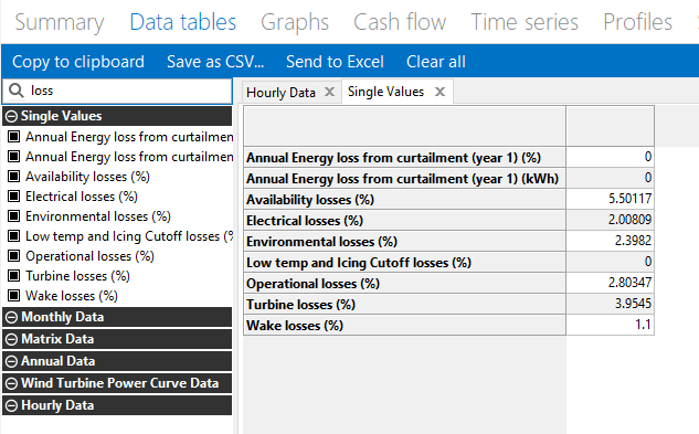

As an estimate of what to expect, I used the following information:
Wind farm size: 303 MW
Total loss: 17.8%
Expected peak output: 303 MW * ( 1 - 17.8%/100% ) = 250 MW
The sum of the various losses on the Losses input page is 16.7%, and there's an additional 1.1% loss from the wake model. You can display all of the loss values on the Data Tables tab of the Results page and export them to a spreadsheet:
Thank you for emailing your file.
Total loss: 17.8%
