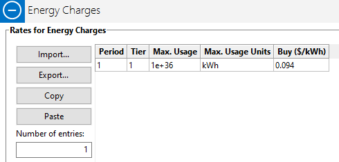

First, you'll need to set up the inputs on the Electricity Rates page for a flat rate: The Rates for Energy Charges table (variable name ur_ec_tou_mat) should have one row, so set Number of entries to 1 and make sure the Weekday and Weekend schedule matrices are all set to 1:

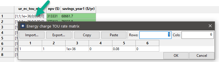

Then, to set up a parametric simulation, click Parametrics, and at the top, click Inputs (Quick Setup does not work for inputs that are tables) to set up the parametric table like this:
For this example, I set up a range of flat rates from $0.08/kWh to $0.15/kWh increments of $0.01/kWh. You could use increments of $0.001/kWh, but I'm not sure it would give you better information and would take longer to set up.
Click the cell in the parametric table under "ur_ec_tou_mat" to edit the energy charge inputs for each row in the parametric table:
