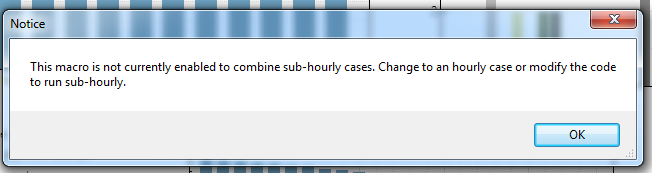

Generic System PV+PV was created by Ayman Housni Mudallal

The "Combine Cases" macro is not designed to work with sub-hourly simulations. If you are using weather files with subhourly (15-minute, 30-minute, etc.) data instead of hourly data, you will have to switch to a weather file with hourly data.
UPDATE: As of SAM 2021.12.02, the Combine Cases macro is replaced by the Calculate generation profiles and nameplate capacity from open cases option on the Power Plant page for the Generic System model and Generic Battery model. See the SAM YouTube channel for a short tutorial .
If you are not using subhourly weather data, please attach a copy of your .sam file so I can investigate.

I double checked and looks like i am using hourly data not subhourly.
here i attached my sam file if you could check on it.
