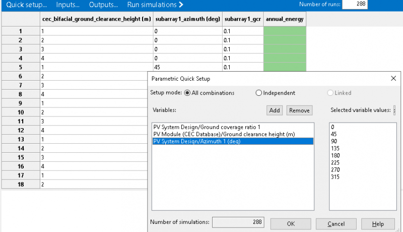

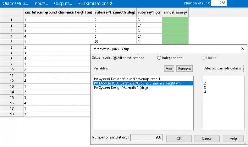

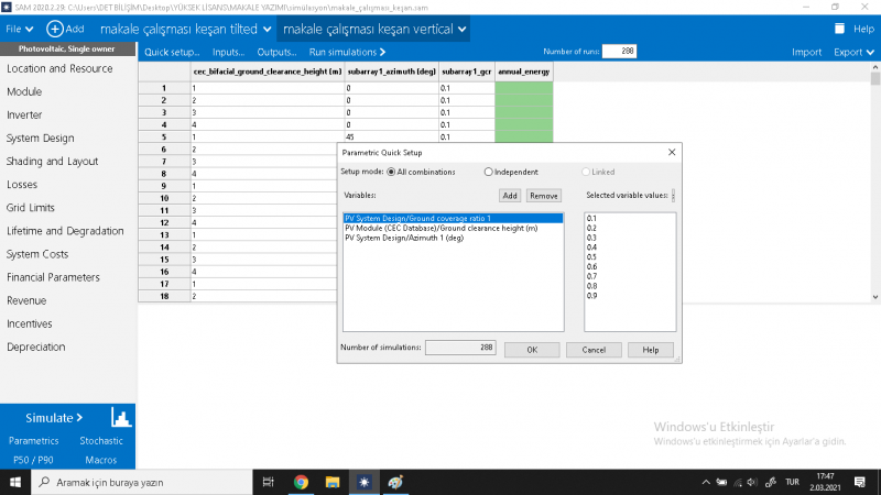

When using the parametric section, the software gives error message "Unknown unhandled exception; terminating the thread in which it happened" and can't finish simulations. I shared the file. I'm working on second configuration (vertical). Please help me. Thank you.

You might consider updating SAM to the latest version, which is SAM 2020.11.29 r2. You keep the older version installed on your computer if you want to compare the two versions.
I was able to run the parametric simulations in SAM 2020.11.29 r2 without an error. I adjusted the inverval between values to reduce the number of simulations so it would not take so long.
