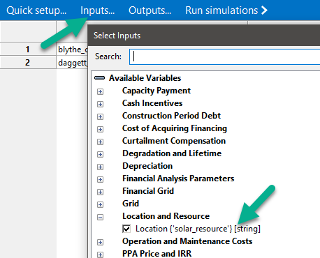

3. Choose Location (solar_resource) as an input variable:

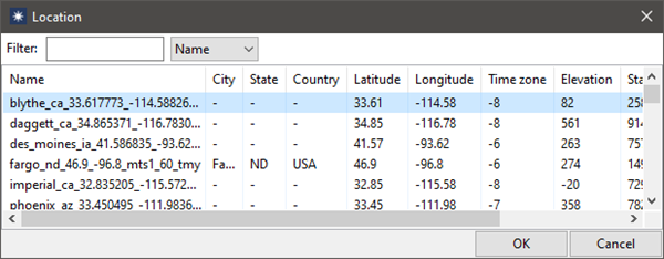

4. Click a cell row in the "solar_resource" column of the parametrics table, and choose the weather file from the solar resource library. This list of weather files is the same as the list you see on the Solar Resource page.
