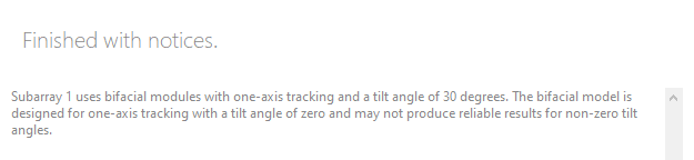

I receive a warning (in the most recent SAM version) that results may not be accurate when I model bifacial modules on a single axis tracker. Does anyone know how significant the difference might be? Where can I find more information about modeling bifacials on trackers?

That message is misleading. The bifacial model should work fine with one-axis tracking as long as the tilt angle is zero. The model was developed from empirical data measured for systems with horizontal tracking axes.
That message should only appear if the tilt angle is not zero. We will fix that for the first update to SAM 2020.11.29: github.com/NREL/ssc/issues/364 .

I am still getting the message "The bifacial model is designed for fixed arrays and may not produce reliable results for tracking arrays." when I use PVWatts to simulate a single-axis bifacial module with 0 tilt. Should I ignore this warning as the previous replies here suggest or has something changed in the last few years that I should be aware of?

You can ignore those warnings. The bifacial model as it is currently implemented should work for both fixed and tracking arrays, and for horizontal and tilted arrays for fixed and tracking arrays.
We will remove these messages: github.com/NREL/SAM/issues/2026
