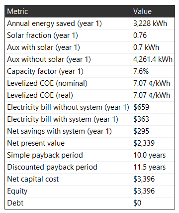

Greeting All:
In solar water heater module in SAM, I was trying to make the solar fraction close to 1 even though I made the size 10 times with no luck. In below snip, we can see the Aux. with solar is very small and close to zero, yet solar fraction is just 0.76. The reason that I see for solar fraction calculation it divide energy saved by Aux without solar. However, if we consider the solar fraction as energy saved divided by sum of energy saved and aux with solar, then we can be close to one.
Your advice is highly appreciated
Majdie.
Majdie.

14 Dec 2020 12:01 - 14 Dec 2020 12:01 #9111
Replied by Paul Gilman on topic Solar fraction calculation in Solar water heater
Hi Majdie,
SAM calculates the solar water heating model's solar fraction as follows:
Or using the names in the metrics table:
The Annual Energy Saved is the sum of hourly or subhourly System power generated:
Solar Fraction = Q auxiliary only (kWh/year) รท System Energy (kWh/year)
Solar Fraction = Aux without solar (kWh) / Annual Energy Saved (kWh)
System power generated (kW) = Q auxiliary only (kw) - Q auxiliary (kW) - P pump (kW)
