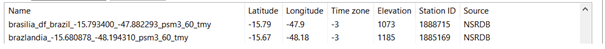

21 Oct 2021 17:31 #10166
Replied by Paul Gilman on topic Error: Azimuth 0 differs Azimuthal Axis performance
Hi Lester,
When you type the latitude and longitude values to download the weather file, please do not include degree symbols, and do not put a space before or after the comma separating the two values.
Regarding AzimuthsampletoSAMsupport.sam:
The latitude and longitude in the weather file is 42.37,-84.7, so this is for a location in the northern hemisphere at latitude = 42.37 with more solar radiation in May - Aug than the rest of the year due to the longer days.
RegardingAzimuthsampletoSAMsupport_2021-10-21.sam:
It looks like you requested a file for -16.67,-49.26 but received a file for 42.37,-84.7. Please try downloading the file again omitting the degree symbol and spaces.

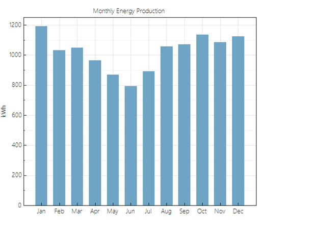

22 Oct 2021 18:09 - 22 Oct 2021 18:09 #10171
Hi Lester,
These latest results look different from the ones you posted before, and seem reasonable for a southern hemisphere location, with the peak output in Oct-Mar and lower output in Apr-Aug.

26 Oct 2021 13:57 - 27 Oct 2021 10:28 #10196
by Lester Izaac
Replied by Lester Izaac on topic Error: Azimuth 0 differs Azimuthal Axis performance
Sorry about that, printed the wrong image.
There it goes:
-15.873383, -47.765404 (this is the location)
[img]
There it goes:
[img]
Last edit: 27 Oct 2021 10:28 by Paul Gilman.

28 Oct 2021 07:33 #10208
by Lester Izaac
Hey, sorry for that.
Prints Attached
Prints Attached
