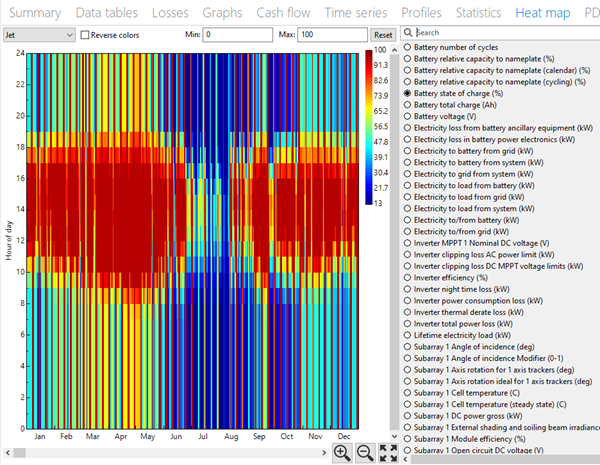

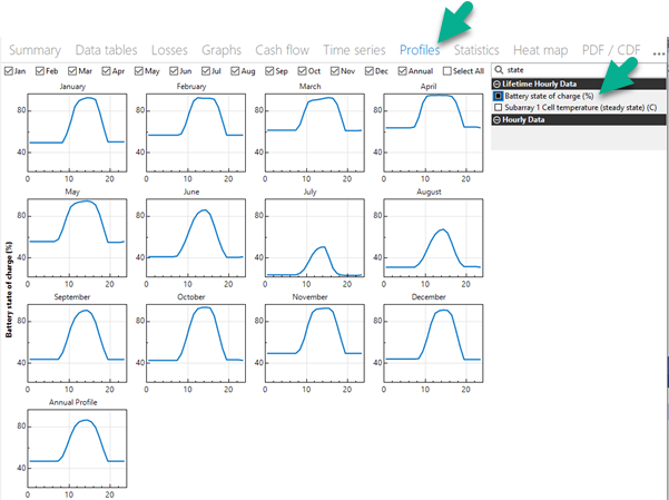

Is there a way to identify Hours at Low SOC/year, medium SOC/Year and High SOC/Year for a battery.
29 Oct 2020 11:40 - 29 Oct 2020 11:41 #8953
Replied by Paul Gilman on topic Battery State of Charge
SAM does not have definitions for high, medium, and low battery state of charge (SOC). It does calculate the SOC for each time step, so you can use graphs on the Results page to identify those times based on your definition of those terms.
For example, displaying the "battery state of charge" output on the Proflies tab shows the average daily SOC by month and for the entire year:
And on the Heat Map tab, you can see a snapshot of the time series data for the entire year:
