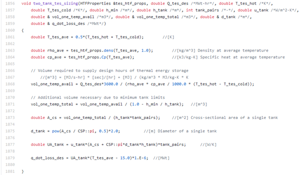

SAM calculates the available HTF volume shown on the Thermal Storage page of the Molten Salt Power Tower model using the same equation you referenced from the physical trough reference manual. The code for that calculation is at github.com/NREL/ssc/blob/develop/tcs/csp_solver_two_tank_tes.cpp .

The HTF property calculations are in github.com/NREL/ssc/blob/develop/tcs/htf_props.cpp .
