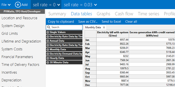

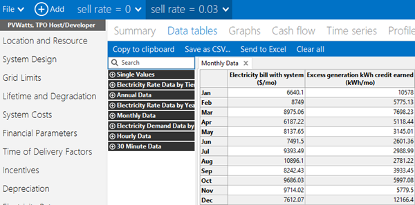

As for the bug, it looks like SAM is not reporting the monthly credit amount "Excess generation $ credit earned/applied" for the Net Billing option. However, the monthly bill calculation is correct. You can verify that using the attached SAM file (based on your file) as follows:
1. In the "sell rate = 0" case, show the monthly "Electricity bill with system" and "Excess generation kWh credit earned" output variables. The latter shows the total excess generation for each month.
2. Show the same outputs for the "sell rate = 0.03" case. To simplify things, I set the sell rate for all TOU periods to $0.03/kWh, so all excess generation in a given month is credited to that month's bill at $0.03/kWh.
3. Note that the bill difference between the two cases is equal to 0.03 * excess generation, so the credit is being applied to the monthly bill. For example, in January, for sell rate = 0, the monthly bill is $6957.44, and for sell rate = $0.03/kWh the bill is $6640.10. The difference is $317.34. The excess generation for January is 10,578 kWh, and $0.03/kWh * 10,578 kWh = $317.34.
