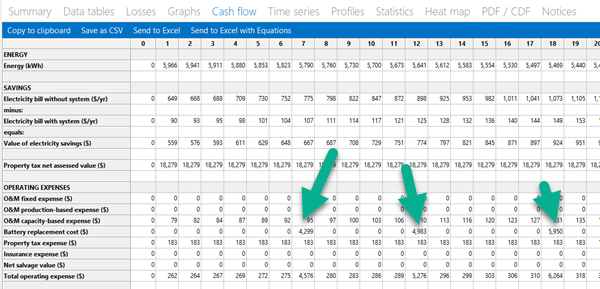

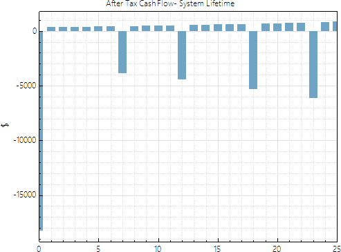

You can use the project after-tax cash flow to help identify ways to increase the net present value (NPV).
For example, in your "PV/Bat Condominio" case, the after-tax cash flow graph on the Summary page shows large expenses in Years 7, 12, etc. It also shows that the annual savings (positive) are very small compared to the Year 0 cost (negative), so even without those expenses, it is unlikely that this project will have a positive NPV.
You can investigate further on the Cash Flow tab to see that those expenses are for battery replacements:

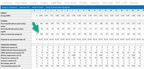

The cash flow also shows that the annual electricity bill savings are small compared to the costs:
To increase the NPV for that case, you could decrease the installation cost, adjust the battery dispatch to reduce the frequency of replacements, adjust the electricity rate, etc.
