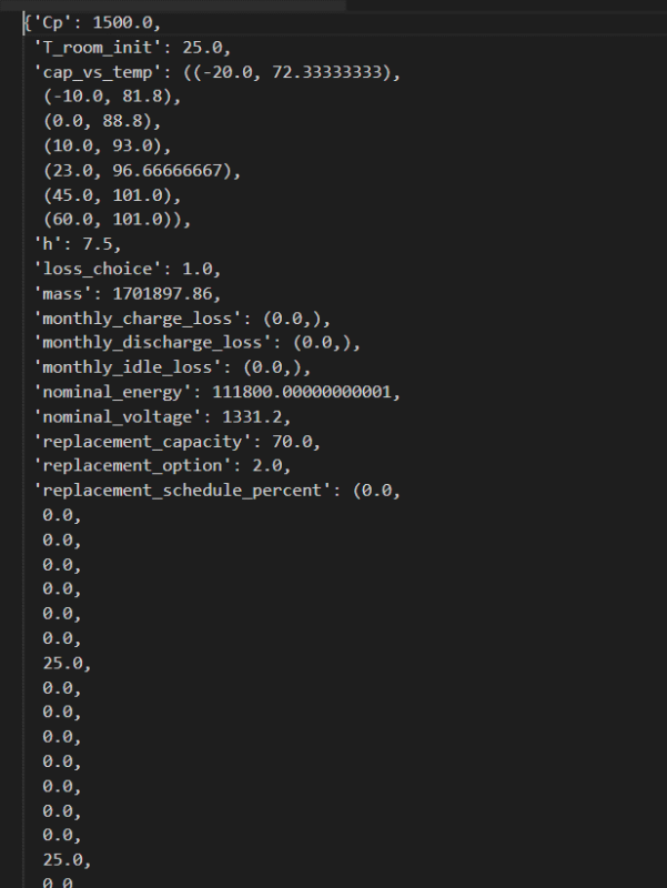

13 Oct 2022 04:33 - 13 Oct 2022 15:11 #11572
by Jawwad Aga
Replied by Jawwad Aga on topic Battery augmentation strategy
Last edit: 13 Oct 2022 15:11 by Paul Gilman.
13 Oct 2022 15:19 #11574
Replied by Paul Gilman on topic Battery augmentation strategy
Hi Jawwad Aga,
Please attach a sample Python script (and any supporting files) that demonstrates the results you are seeing if you would like me to help troubleshoot.
