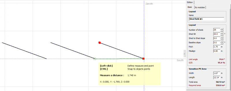

Good Day Paul,
Decreasing GCR reduced the module loss. But I would like to keep a row spacing of 1.75 m between two arrays.
Attached the PV system design for reference.
And I kept the same pitch: 1.75 m and GCR: 95.4% in PVsyst and I got less module loss and more Annual energy output under same conditions.

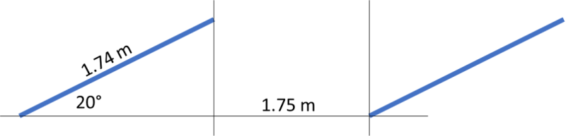

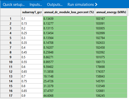

Hi Karthik,
Based on the information you provided, I calculate GCR = 0.51:
GCR = 1.74 / ( 1.74 * cos( 20 ) + 1.75 ) = 0.514
I used SAM's parametric simulations in the attached .sam file to generate this table showing the annual output and "module deviation from STC" loss for a range of GCR values:

But in SAM row spacing of 1.75 m is different from the one you calculated (1.74 * cos( 20 ) + 1.75 ).
And also in the attached PV system design, the arrays are closer with a total pitch(row spacing) of 1.75 m only, this leads to GCR 0.954 (same in case of PVSyst)
Karthik.
