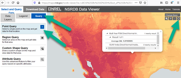

You can use the NSRDB Viewer to explore the PSM V3 data at nsrdb.nlr.gov/ .
