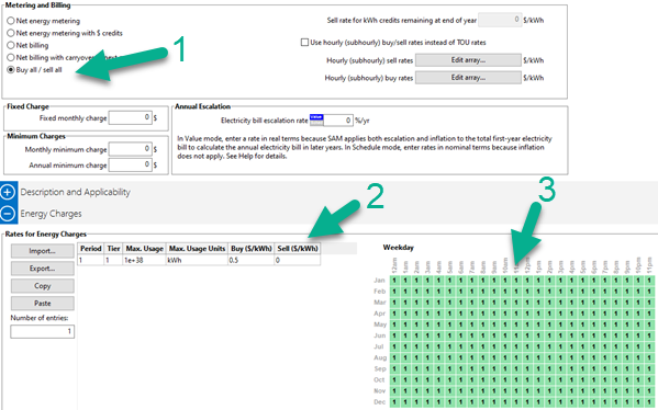

SAM does not model diesel generators and assumes the grid is always available to meet the load when needed or unreliable grid. You could use "Electricity from grid" to represent power from the grid and generator. On the Electricity Rates page:
1. Choose the "Buy all / sell all" metering option.
2. For the energy charge rate table, set Number of entries to 1, set the sell rate to zero and the buy rate the aggregate price of electricity in $/kWh to represent purchases of both diesel fuel for the generator and electricity from the unreliable grid.
3. Set the Period in both the Weekday and Weekend tables to 1. (Use your mouse to select the entire table and type "1" on your keyboard.)
For that approach to work, you would need to size the PV array / inverter and battery bank to minimize exports to the grid.
