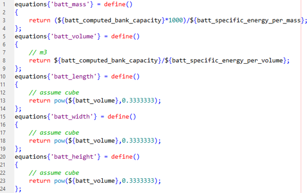

I am working on a battery model based on SAM. I managed to replicate the voltage model and I know have moved on to the thermal model. How is the battery area calculated? I can only find the volumetric density (Wh/L), but no correlation to the actual area.

SAM's battery thermal model makes a simplifying assumption that the battery shape is a cube, so the battery area can be determined from its volume. That calculation is performed (internally) by the SAM user interface to calculate values of batt_length, batt_width, and batt_height as follows:
Note that we are making changes to the battery code, so in the next version of SAM (Fall 2020), batt_area will replace the length/width/height variables.
