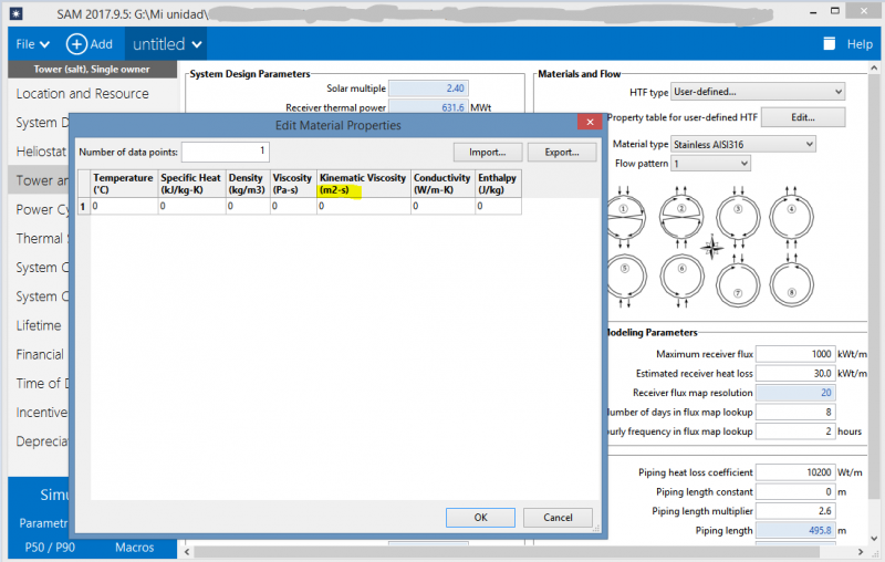

I was diving in SAM, and in the section of User-defined HTF type in the Tower (salt) Single Owner I have some doubt.
1. In the 2020 version this alternative don't work (I already sent a message about that, but which is unpublished yet).
2. In the 2017.9.5 version, the table appears to have wrong the dimension units of viscosity. That may me get confused to know which value need I to put on it.
Regards,
Matías D. Castro Q.-
Regards,
