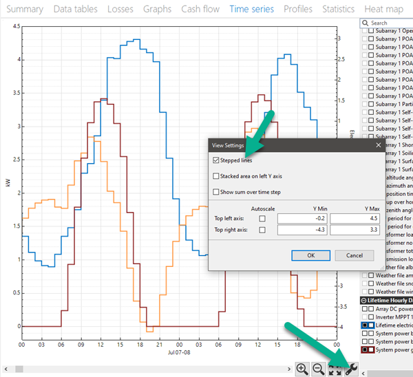

I am having difficulty with designing a stand-alone PV system without a grid. Is there a way to turn off "Electricity supplied to/from the grid" in SAM to only isolate your PV system. As you can see in the graph attached, our system is supplying electricity to the grid (green plot), although the load (orange plot) is not being satisfied. Is there a way to turn off the "Electricity Supplied to the grid"?

SAM's photovoltaic models assume that the PV system is connected to the grid so that PV power in excess of the load goes to the grid, and load in excess of PV power is met by the grid. You can try to design a system to minimize power to/from the grid, but there is not a way to completely eliminate it. For example, SAM will use grid power to meet the inverter night-time consumption.
The graph is a little hard to read, so I can't tell exactly what is happening. Sometimes it's easier to tell what is going on by looking at the data tables, or displaying the graph in "Stepped lines" mode.
