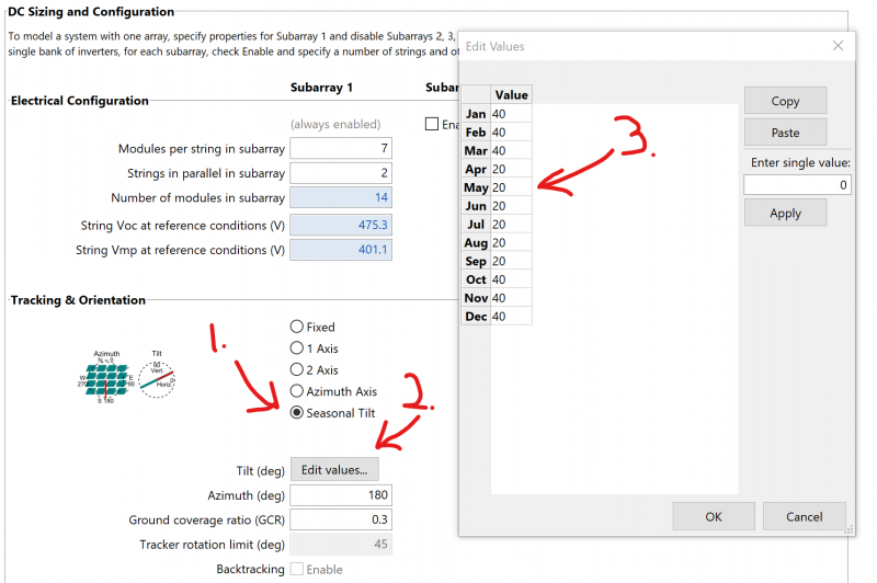

Does "seasonal-tilt tracking" means two or four tilt per year?
How does sam calculate this angle?

The seasonal tilt option for tracking (Detailed Photovoltaiic model) allows you to set the array tilt angle for each month of the year. The tilt angle is in degrees from horizontal, so a tilt angle of zero would be for a horizontal array, and a tilt angle of 90 degrees would be for a vertical array.
