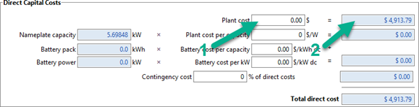

There is a bug in the Combine Systems macro that you can see on the System Costs page of the Generic System case. The macro sets the value of the calculated plant cost (2 in the screenshot below) instead of the input field (1). You can work around the problem by typing the value in (1) -- in this case type 4,913.79 and then click the Simulate button in the Generic System case (don't run the macro again):

Thanks, that appears to have worked once I manually put the price in that field.
