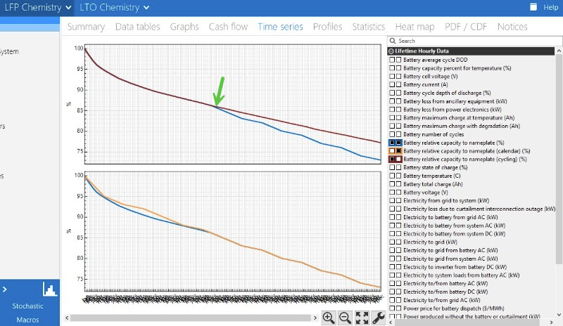

First, I would like to confirm my general understanding that - battery degradation is affected simultaneously by both charge/discharge cycles and battery age. So I would like to know why the custom 'Cycle and Calendar Degradation' mode under "Battery>Battery Life>Battery Life Options" section is resulting in minimum of what either of those models results in.
Simulating an LTO battery using 'Li-ion LMO/LTO' model under the same section, results in the degradation being close to the product of the individual degradations.
I have attached simulation results of LFP chemistry with default cycle and a custom calendar degradation to highlight my point. And LTO chemistry with built-in LTO model. I look forward to hearing from you and hoping for some clarity.

When you choose the "Cycle and calendar degradation" option on the Battery Life page SAM calculates capacity fade caused by both, and as a conservative assumption, applies the smaller percentage. In the "LFP Chemstry" case that you shared, SAM applies capacity fade due to battery cycling at the beginning of the battery's life. As the battery ages, calendar life capacity fade applies:

For LTO, I am already using the "Li-ion LMO/LTO" model in battery life options. The screenshot I have posted in my earlier post depicts the simulated result. The overall degradation (coloured blue) appears to be the product of the individual cycle degradation and calendar degradation curves. These series are selectable in Time Series section of the results, even though there are no user inputs pertaining to them when using the LMO/LTO model.

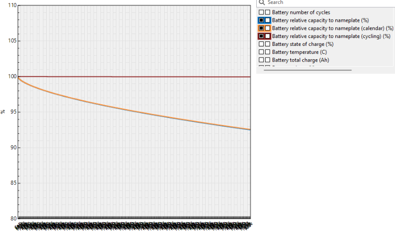

When you choose the LMO/LTO battery life option:
The time series results should show capacity fade due to cycling at a constant 100% so that the battery capacity fade is represented by the calendar capacity fade:
If you are seeing different results, please attach a copy of your .sam file so I can investigate.
