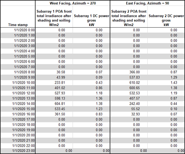

14 Apr 2020 17:58 - 14 Apr 2020 17:59 #8121
Replied by Paul Gilman on topic Power Production vs. Time of Day for different sub-arrays
Hi Les,
Attached is a .sam files for a 5 kW PV system configured with two subarrays. Both have a tilt angle of 20 degrees with Subarray 1 facing West and Subarray 2 facing East. The table below shows results for a system with a fixed array (no tracking) for January 1:
You can see results for the entire year and for a one-axis tracking array in the .sam file.
If you have a file that shows different results, please attach it and I would be happy to review it.
- In the morning, the East-facing subarray is exposed to more sunlight and generates more power than the East-facing array.
- At Noon, both subarrays generate about the same amount of power.
- In the evening, the West-facing array generates more power than the East-facing one.
Last edit: 14 Apr 2020 17:59 by Paul Gilman.

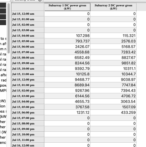

- Les Fritzemeier
04 May 2020 11:25 #8170
by Les Fritzemeier
Replied by Les Fritzemeier on topic Power Production vs. Time of Day for different sub-arrays
The attached screenshot shows the output from a 25 degree E-W array modeled in Topsham Maine. East and west subarrays are identical. You can see that the array turns on at 4:00 a.m. at about 100kW output for each subarray. That is VERY early in the morning for Maine!! All goes as expected until 6:00 p.m. when the array shuts off. West is still over 1200 kW and east is producing over 400kW. Makes no sense at all. It looks time shifted to early in the day. The result is that the array appears to not be generating during some of the most valuable time of day, when pricing is peak. Any ideas at all on this? Both the time shift and the apparent premature shutdown in the model are of concern.
Thanks again,
Les Fritzemeier
Thanks again,
Les Fritzemeier
