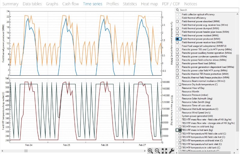

Dear Paul,
The linear Fresnel molten salt model still giving unspected results for the plant behavior.
Now I am simulating a 2 hours storage with a solar multiple 2 and the thermal storage is dispached several times after sunset, as shown in the next figure. For a storage capacity larger then 2.5 hours, this behaviour disapeares.
Please check this issue in the next revision.

18 Oct 2019 12:30 #7739
Replied by Paul Gilman on topic Linear Fresnel Molten Salt Storage Dispatch
Dear Rafaela,
Would you mind sharing a .sam file that demonstrates this behavior?

Dear Paul,
Please find attached the . sam file. I changed the location (since I can't share the data), but the behaviour is similar.
Regards,
Rafaela
Regards,
Rafaela
Hi Rafaela,
Thank you for sharing the file and letting us know about this issue. It turns out to be caused by a bug in the code that we have fixed for the next version of SAM. We are working now on that version and hope to release it late this year.
