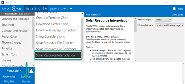

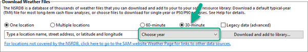

Note that you can use the "Solar Resource Interpolation" macro to convert the hourly data to 15-minute time steps, and that the NSRDB data for specific years is available in 30-minute time steps if that better suits your analysis than the hourly data.

Thank you - the solar resource interpolation ended up working well for what I was trying to do.
