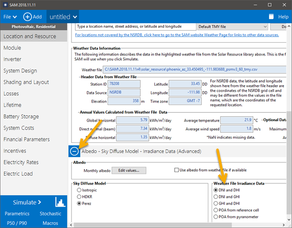

Dears,
I'm a french student and I'm using SAM for an internship.
I use a file zith only GHI and DHI, so I want use you irad_mode = 2.
The probleñ is I dn't kmow where I must put this line. I'm using the user interface, must I use the SDK? A module for the SSC? Or use GIT?
I read the SSC guide and the SAM help, but I'm lost in all the informatons.
Best regards.
Best regards.

Dear Remi,
You can use a weather file that contains GHI and DHI if you use SAM's Detailed Photovoltaic model. You will find options for different combination of irradiance components on the Location and Resource page, under "Albedo - Sky Diffuse Model - Irradiance Data (Advanced):
