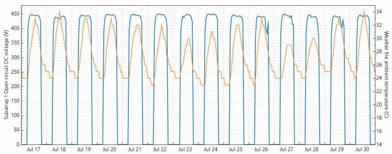

08 Aug 2019 09:06 #7605
Replied by Paul Gilman on topic System Design step
Hi Carlos,
The information you see on the System Design page are system parameters under design conditions. These values determine the system's nominal or nameplate capacity.
The Location and Resource page shows values calculated from the data in the weather file. That information describes the ambient conditions at the project site.
When you run a simulation, SAM calculates the system's performance parameters for each time step (hourly by default) over one year. Those parameters include the module operating voltage and temperature. You can see that information on the Results page, for example on the Time Series or Data Tables tabs.
