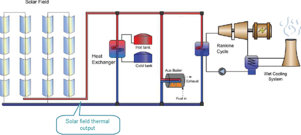

I am trying to simulate a parabolic trough collector thermal plant. I have been studying the results from SAM and I understand the sequence of calculus of thermal parameters but I have still some doubts with some of these parameters:
1. I would like to know how is obtained the parameter “Thermal energy absorbed”. I have calculated this parameter with the following formula:
Thermal energy absorbed = Total incident thermal energy * Collector average optical efficiency - Receiver thermal losses
Nevertheless, I have found some differences among my results and SAM. What other parameters are used to obtain “Thermal energy absorbed”?
2. I don’t understand the step between the “Thermal energy absorbed” and “Solar field thermal output”. I see that “Solar field startup energy” affects to the value of “Solar field thermal output”, but it is not the only parameter that affects. What is the “Solar field startup energy”? What other parameters affect to the “Solar field thermal output”?

I think that I have understood the physical meaning of the parameter "Thermal energy absorbed": is the thermal energy absorbed by the collectors, before thermal losses and including optical losses. Nevertheless, I can't fit my results with those of SAM.
Moreover, I don't understand the parameter "Solar field thermal output". I have studied the results from SAM and it seems that "Solar field thermal output" is, more or less, the Thermal energy absorbed less the Solar field startup energy and the piping losses. What is the meaning of the Solar field startup energy? Why it has values different from 0 during the day?
Can you explain me these parameters? I have found no answer in the manual. Please find attached an Excel spreadsheet with my calculations and my differences with SAM.

I continue with my doubts. I think that I can't fit my results with those of SAM due to the defocusing of the colector.
Nevertheless, I continue ignoring what is the meaning of the "Solar field thermal output", where is this parameter measured in a solar plant.
Thanks in advance
Igor
