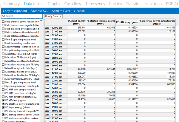

Are you comparing thermal to electrical energy? in my original claim what I have done is: I went to the tabular data, computed the following:
Manual gross electricity generation= ("PC input energy" - "startup energy" )x0.356
and compared it to the "PC electrical power output: gross" I am obtaining 8% larger value for the gross vs the manual computations which is leading me to believe that there's a certain boiler back-up of 8% being added to the PC input energy.
What do you think

Hi Jessica,
This screenshot shows the Data Tables tab on the Results page with variables that show that for hours except startup hours,
PC Gross Output (MWe) = PC Input (MWt) * PC Gross Efficiency
For startup hours, please see my final response in this thread: sam.nlr.gov/forum/forum-general/1987
