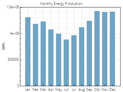

For a PV array with one-axis tracking, when the tilt angle is zero for a horizontal tracking axis, I would expect the system's output to be higher in summer months and lower in winter months. Tilting the tracking axis so that the array faces north in the Southern hemisphere has the effect of reducing the total monthly incident solar irradiance in summer months and increasing it in winter months compared to the horizontal tilt angle.
For example, from your .sam file and weather data, for Tilt = 0 and Azimuth = 0, you can see a clear pattern of higher output in summer months and lower in winter months:

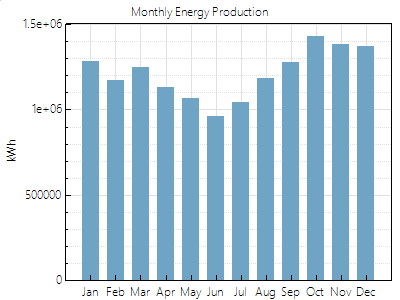

Changing the tilt angle to 10 degrees with Azimuth = 0 slightly increases the winter monthly output and decreases summer monthly output.

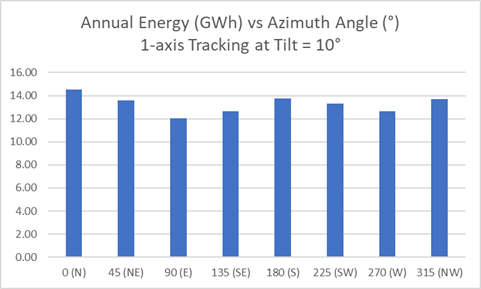

As for the optimal azimuth angle, for a tilt angle of 10 degrees, and a range of azimuth angles from zero to 315 degrees, the maximum annual output is for an azimuth angle of zero:
I generated these graphs from the attached version of your file. For the Annual Energy vs Azimuth Angle graph, I ran a parametric simulation by clicking Parametrics under the Simulate button.
