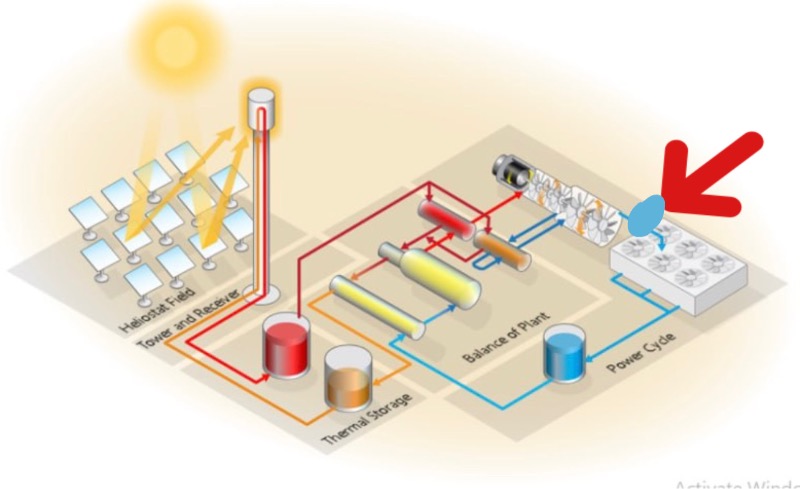

- Ahmed
18 Aug 2024 18:09 #13392
by Ahmed
Replied by Ahmed on topic Solar Tower molten salt
20 Aug 2024 07:57 #13395
Replied by Paul Gilman on topic Solar Tower molten salt
Hi Alasadi,
SAM's Molten Salt Power Tower model reports the "PC condenser water outlet temperature" and "PC condensing pressure". It does not report metrics for the condenser inlet.
- Ahmed
20 Aug 2024 09:40 #13397
by Ahmed
Hi Paul.
Thanks for the quick response.
Is there another way to know the pressure and temperature entering the condenser in the SAM ?
Alasadi
Alasadi
