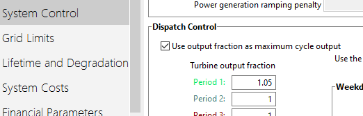

Replied by Paul Gilman on topic Ignoring CSP Dispatch Control Strategy when TES is full
There are two maximum power limits that you can set for the power tower (and physical trough) models: The dispatch "Turbine output fraction" on the System Control input page and the power cycle "Maximum turbine over design operation."
In versions of SAM up to 2018.11.11, SAM allows the power cycle to operate at the over design operation level even if it exceeds the dispatch output fraction. For SAM 2020 (available at the end of February), we have implemented a new option so you can choose to limit the power cycle output to the dispatch fraction:
