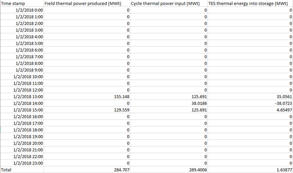

In my comment above, I was looking at hourly results. You are looking at monthly totals.
For a system with storage, consider this data for a single day. You can see how the daily sum of power values to power block is greater than the sum of power values produced by the field:

And I am confused what leads to the result that the power values to power block is greater than the sum of power values produced by the field in daily sum, month sum or year sum data. Could you explain it to me?
why is the energy produced by field less than Cycle thermal power input (MWt)plus TES thermal energy into storage (MWt) at a time point in hourly data you commented?
I try to find the loss energy by changing the row spacing, but i only find the shadowing loss efficiency instead of energy in the result.Could you tell me how to calculate shadowing loss energy by using hourly data in the result?
Best regards
Lisen huo
I am really appreciated for your information.

The reason that the sum of hourly power to power block is greater than the sum of power produced by field over some period of time is because of the nighttime hours when energy from storage goes to the power block. You can see that in the table above.
You can estimate the shadowing loss by multiplying the "Field collector row shadowing loss" by "Field thermal power produced."
