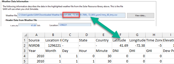

The National Solar Radiation Database (NSRDB) uses approximately 4 km square map grid cells. If the latitude and longitude values of the location in your request fall within the same grid cell, then the requests will return the same weather file. You can verify this by opening the .csv weather file and comparing at the latitude and longitude values in the file with the lat/lon values you used for the request.
In the file name SAM constructs when you download a weather file, it puts the location name (or lat/lon pair you used for the request) at the beginning of the file name and the lat/lon of the grid cell at the end of the file name so you can see the difference.
