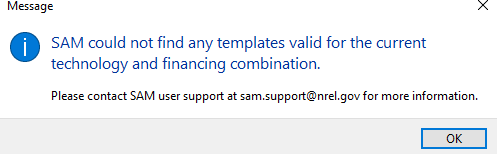

Dear Sirs,
Whenever I generate the report for PV-Battery Storage System, below message pops up. Could you please advise?
Thanks.
Thethttps://mail.google.com/mail/u/0?ui=2&ik=ccccf79a35&attid=0.1&permmsgid=msg-a:r115035464783757694&th=1711a855f56df1a3&view=fimg&sz=s0-l75-ft&attbid=ANGjdJ9pTlFeTGx7IT9XLI84pg1PxQjWqHFvGYwfpm-0vLLNbZowFRTXHPnNSJOG-NwL-cZOSk-moZv1mQZEbwRUfxdpgjtXi7rEDRY-ts8vxQHO3ZFW-wl_W_pFpRY&disp=emb&realattid=ii_k89rdy7s0
Thanks.

27 Mar 2020 14:39 #8080
Replied by Paul Gilman on topic SAM could not find any templates valid for the current technology
Hi Thet,
We have not yet designed a report template for the battery storage configurations.
