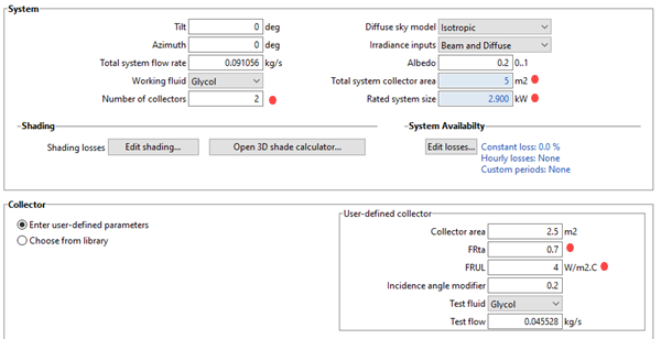

Hi Russ,
The equation in the user interface on the Solar Water Heating input page for Rated System Size seems to be working in SAM 2021.12.02 r2 as described in Help.
For example, this screenshot shows inputs for Collector Area = 2.5 m2, FRta = 0.7, FRUL = 4, and Number of Collectors = 2.
The equation given in Help is:
Nameplate Capacity = Total Collector Area × ( FRta - FRUL × 30/1000 )
5 * ( 0.7 - 4 * 0.03 ) = 2.9
