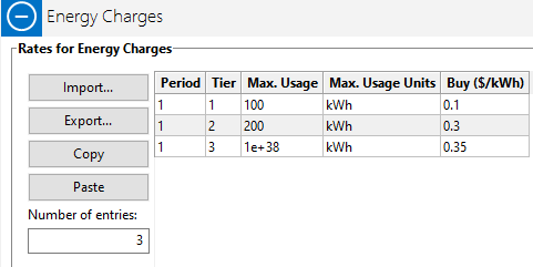

On the Electricity Rates page, you can see that the electricity rate structure has three tiers:

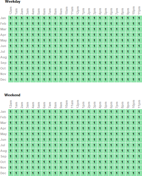

There is only one TOU period, so I set the period on the Weekday and Weekend schedules to 1 with my mouse by selecting the entire schedule and typing a "1":

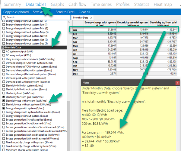

You can run a simulation and verify the results:
