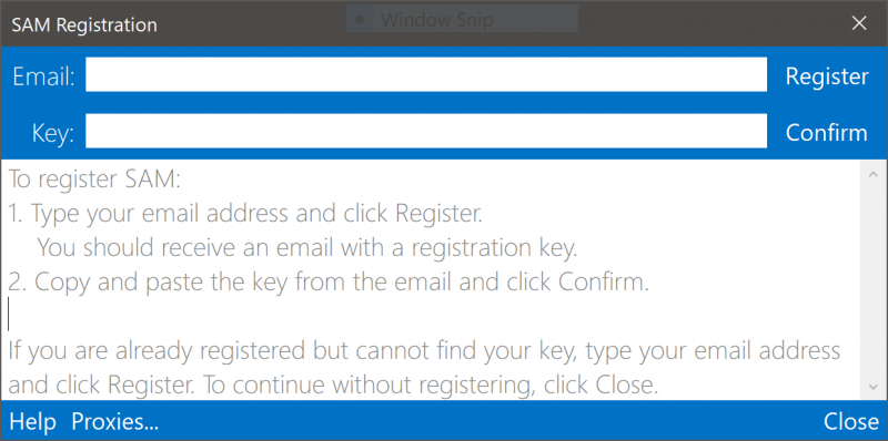

SAM requires a registration key that you request by providing an email address the first time you start the software. The registration key is free and can be used on more than one computer and for different versions of SAM. The registration key does not expire.
When you start SAM for the first time after installing it, it displays the SAM Registration window where you provide an email address to register your copy of SAM. Registration is free, and allows us to keep count of how many people are using SAM. We use this information in our reports to the U.S. Department of Energy, which funds NREL's work on SAM, making it possible for you to use the software for free.
After your copy of SAM is registered, each time you start SAM, it connects with NREL servers to verify your registration. If you start SAM while your computer is not connected to the internet, the registration window will appear and allow you to continue to SAM without connecting to the servers up to 15 times. If you reach the 15 start limit, you must start SAM while your computer is connected to the internet to refresh the start counter.

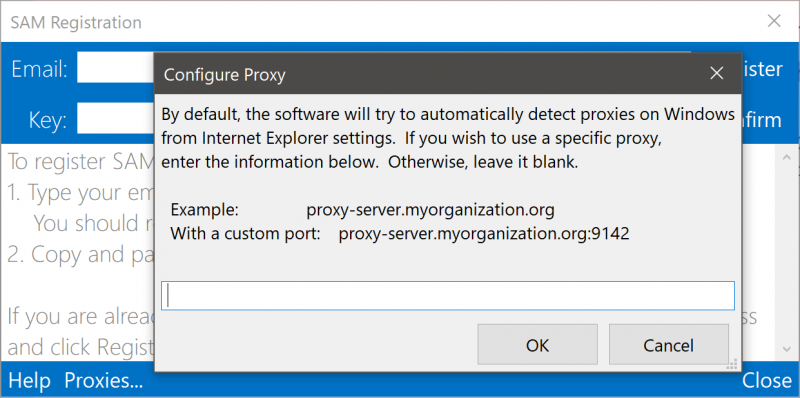

Configure SAM to Work with a Proxy Server
If your computer uses a web proxy server to connect to the internet, you can create a proxy configuration file that will allow SAM to connect using your proxy server address. You can either create the file in a text editor, or use SAM's proxy configuration window as described below. The file is named proxy.txt and contains a single line with the proxy server URL and optional custom port as described in the instructions below. The file should be in the folder that contains the SAM executable file in your SAM installation folder.
To remove the proxy configuration, either delete the proxy.txt file, or delete the proxy server URL from the proxy configuration window.

To request a new or existing key and register SAM:
- If you have not yet installed SAM, download and install the software.
- Start SAM, and type your email in the Registration window and click Register.
If you already have a key but don't know what it is, type your email address and click Register without entering a key.
You should receive an email with your key within a few minutes. - Paste the key from the email into the Registration window and click Confirm. Be careful not to include any spaces at the end of the key when you select it to copy.
- In the Registration Information window, click OK to finish registering or Cancel to cancel the registration. If you do not see the OK and Cancel buttons, press the Enter key on your keyboard to register, or close the window to cancel.
To create a proxy configuration file:
- Start SAM.
- If you do not see the Registration window, click Registration in the bottom left corner of the Welcome page. If SAM is open, close the current project to display the Welcome page.
- In the Registration window, type the email address and registration key if the fields are empty. If you do not have a key, register to request one as described above.
- Click Proxies.
- In the Configure Proxy window, type the proxy server's URL. For example, if the server's address is "proxy-server.myorganization.org," type:
Code:proxy-server.myorganization.org
- To specify a custom port, add it to the name with a colon separator (no spaces). For example, if the server address is "proxy-server.myorganization.org," and the custom port number is 1234, type:
Code:proxy-server.myorganization.org:1234
- Click OK to close the Configure Proxy window, and Close to return to the SAM main window.
